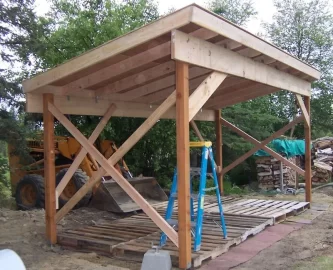

    Build 2, then no worries. :)
    8' X 12' a good size. Less cutting dimensional lumber
    I used pier block for footings & a pallet floor.

    I really like the look of this one and it's simplicity.
    Thanks for posting!
