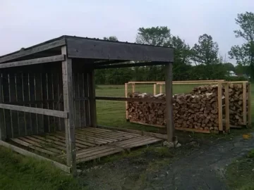

if you have some knowledge of doing some building you can build something like this. i only spent 385 bucks for materials. i also got the roughing and nails for free but still. few hundred bucks and you could have somthing that holds a lot more than the home cheapo thing and get better airflow.

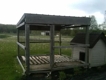

Couple hundred bucks and a weekend with some buddies and beers, gets it done. This started life as a dog kennel till last weekend. Took off the front, removed the dog house, put some back boards on the North side, and laid down some skids. About 10 x 9. Not the biggest. But it will hold a few cord.

Judging from the size of that doghouse, you can have the dog bring in the wood a mouthful at a time. Now that would be a step forward in the long history of wood burning.
It was 6 ft long x 3 ft deep x 5 1/2 ft tall. Big Shepard that used to call it home. Now his lazy butt just stays in the house.
