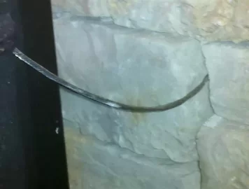

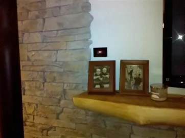

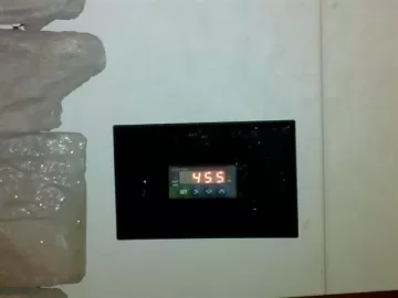

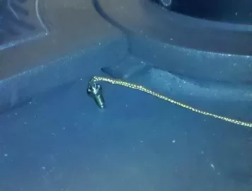

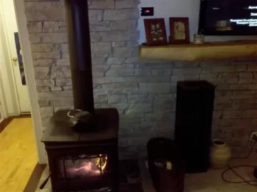

This is my new T5, burned the first fire in October this season. I grew up burning with wood and feel comfortable for the most part. The only thin that worries me is when I'm not around for extended time and the rest of the family is in charge of the stove. My wife tends to defer the duties to my two boys 12 and 15. Smart kids, responsible, and good learners. So, my goal was to have a more definitive way of explaining the different stages of a fire to the boys. And have a hard, fast rule for when the stove gets turned down. Nothing against the stove top thermometers, just didn't work great for me with the T5.
This is perfect. Inexpensive, clean and accurate.

If you can get a thermocouple to stand on end without falling over, great idea.
Its hard to tell from the pic but the thermocouple is pinned under part of the trivet top. Works great on a Alderlea, probably need a horse shoe magnet for other stoves.

Tech industry, No. Just a dumb commercial fisherman by summer and unemployed General Contactor the rest of the season. Super easy to install, the hardest part is getting power to the temp controller but if you have an outlet nearby its easy. I had one on the other side of the wall in the same stud cavity where I put the controller, so all I had to do was fish a wire from the outlet up to the controller.
Volemister, I have no idea why the industry doesn't provide thermometers. But if I had to guess, it would have something to do with liability.
Lighting up, I got it off ebay. Wood Stove Thermocouple. Think I paid $120

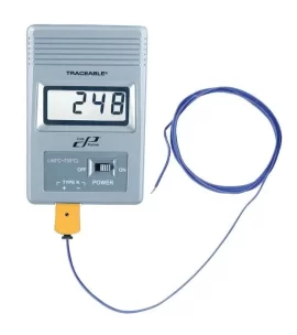

Hello
I have searched the Internet and found an inexpensive accurate digital thermometer to measure up to 1500 Degrees! It is the Cole-Parmer� Remote-Monitoring Thermocouple Thermometer. However the High temp probe is another $65.00 but together they work great!!
http://www.coleparmer.com/catalog/product_view.asp?sku=8646003
Large pic
http://www.coleparmer.com/catalog/large_image.asp?sku=8646003&img=86460_03 _05.jpg
This meter has a 4-ft. ribbon micro-cable that allows you to place the probe within an area and close the door without affecting the probe or the door seal. Accurately monitor temperature within freezers, water baths, heating blocks, incubators, refrigerators, and other areas. The meter includes a fast-response type-K probe that can be used for general purpose applications. Users can also choose from a wide verity of probe sold separately for surface, liquid, air or semi-solid materials.
What�s Included:
one beaded-wire type K probe, NIST-traceable certificate, leatherette case, and one 9 V battery
Specifications
Temp range -58 to 1382�F
Resolution 1�F
Accuracy �2�F .75% between 32 to 932�F and �2�F 1% between 933 to 1382�F. Below 32 accuracies are: -4 � 8�F, -40�F � 8�F, and -58�F � 10�F
Probe Thermocouple
Display 4-digit LCD, 0.7� high
Probe type Type-K
Probe(s) included Yes
Dimensions 2 3/4� W x 4 1/4�H x 3/4� (76 x 114 x 18mm).
Power 9-Volt Alkaline battery (included)
Here are the high temp probe specs…..
http://www.coleparmer.in/catalog/product_view.asp?sku=0850562&pfx=WW
WW-08505-62
Type K Small-diameter thermocouple probe with miniature stainless steel handles;8"L
Qty: Add to Cart
$64.00 / each (USD)
Click for discounts : In stock.
Product Rating
0 stars
(0 Ratings)
Write a Review
Search through our large selection of Thermometers!
Choose from a wide variety of general-purpose standard, micro-, and heavy-duty probes. Probest with handle feature straign relief spring that protects the cable connection against damage due to repeated flexing and tugging. Standard glass-filled polypropylene handles measure 5.5"L.
Specifications
Type K
Temp range -418 to 1500�F (-250 to 816�C)
Probe length 8â€
Diameter 0.063â€
Cable length 5 ft
Response time 10 sec
Connections miniconnector
Time constant 2 sec
Junction grounded
Sheath material 316 SS
Handle SS
