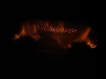

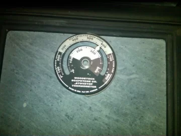

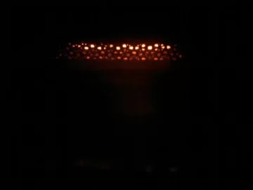

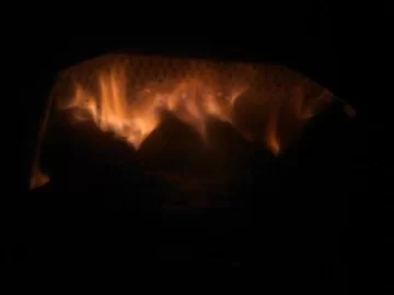

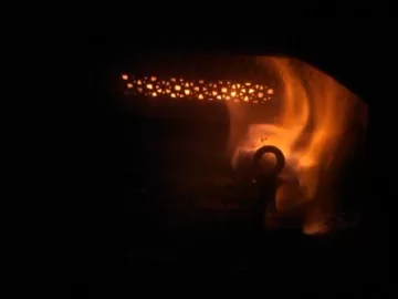

    Here are a few pics from last night's no fire - only cat and secondaries coming off the cat burn. The stove is more dirty than the chimney sometimes I think... ;)

    How fast are those flames moving? With a VC cat stove I've found that when it's engaged the flame and glow kind of take on a liquid effect. The flames move slow and look thick. Almost bubble up from the base of the firebox. The flames lick up and then back to meet the back panel opening for the cat.

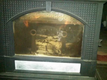

    Nice pics, looks familiar. Does that dirty glass burn off when you turn it up, mine does but sometimes it takes awhile.

    The flames are sometimes slow and move around the top of the stove like a cloud. Other times they just explode onto the scene, dance around a bit and are gone - only to return several minutes later. Mostly, there are no secondaries - just a glowing cat on a burn like I had going.

    Todd,
    The glass burns off when I turn it up. Sometime it all burns off totally, other times not as much. Once the temps plunge, and my daytime fires are hotter, it will burn totally clear until spring. I think the build-up on the glass is more a function of air flow moving through the firebox. With a super low burn like I'm doing, there just isn't enough air velocity across the airwash plate to keep the black stuff moving.
    But I need to get in the stove and wipe down the fly ash and get the spot of burned jammies off the front glass. What/how are you cleaning the cast iron surface?

    With the stove hanging around at 300-400° what type of burn time do you get?

    Usually when there is a smoke only burn, the cat (being at the top of the stove) gives me a steady 500 degree stove top burn. I could damper it down more. At 500 degree burns and down from there as the wood is used up, easily 8 hrs. One thing about the soapstone is that it really retains heat and radiates it after the fire goes down, so there is heat still radiating the room for at least an hour or two. So if I load the stove at 10 pm, even if the fire s on the way down at 4 am, the stove is has plenty of stored heat to radiate. If my old part of the house was insualted, the stove heat would be even more impressive.

    It's hard to get the stove top to stick around at 300-400 on a low burn because the cat is right underneath. So you could be at a smouldering no flame cat burn and see stove top temps up around 600+ but the rest of the stove is relatively cooler. On the other hand you could have a full flaming box fire going and the stove top is only 500+ but the whole stove is putting out much more heat. I'm thinking the VC's are similar but the cat is in the rear of the stove instead of the top so your griddle will show lower temps than the rear.
    I'm still experimenting but so far my probe gives me a more accurate view of what's going on with my stove than stove top temps or pipe temps. There are times when I turn it down to a low cat burn and the probe will shoot up for awhile as the cat gorges itself on smoke but it reacts so much quicker than the soapstone top or pipe temps. So far I've been able to keep it under that 1600 cat danger zone and I know in the past I was easily over it without knowing. It should help extend the life.

    I always get soot on the right side while doing a cold start and if I let it burn hot it disappears, if I turn it down to a low burn too soon it stays. This is the basement stove, haven't burned the other one yet but I think I had the same problem with that one. I tried adjusting the air wash every which way and had conversations with Woodstock about this but they recently stopped communications since they're too busy with the new stove which I can understand. Once going 24/7 the glass seems to stay clean even with slow burns but it still bugs me why I get these uneven burns left to right.
