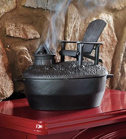

    Looking at the two items placed atop the stove, I figure the one on the left is a steamer, although clearly equipped with far more gadgetry than mine (got a pic?). What's the thing on the right, though?

    It's a fan for circulating the heat. I've thought about getting one, but am too cheap. ;) The blades turn from the heat, so you don't need power to run it.

    I see it now! Thanks, Melissa.

    Left one is a steamer, pretty neat, the steam comes out of the campfire on it: http://www.amazon.com/Adirondack-Chair-Stove-Steamer-Black/dp/B007JXWXKQ/ref=pd_sim_sbs_hg_1
