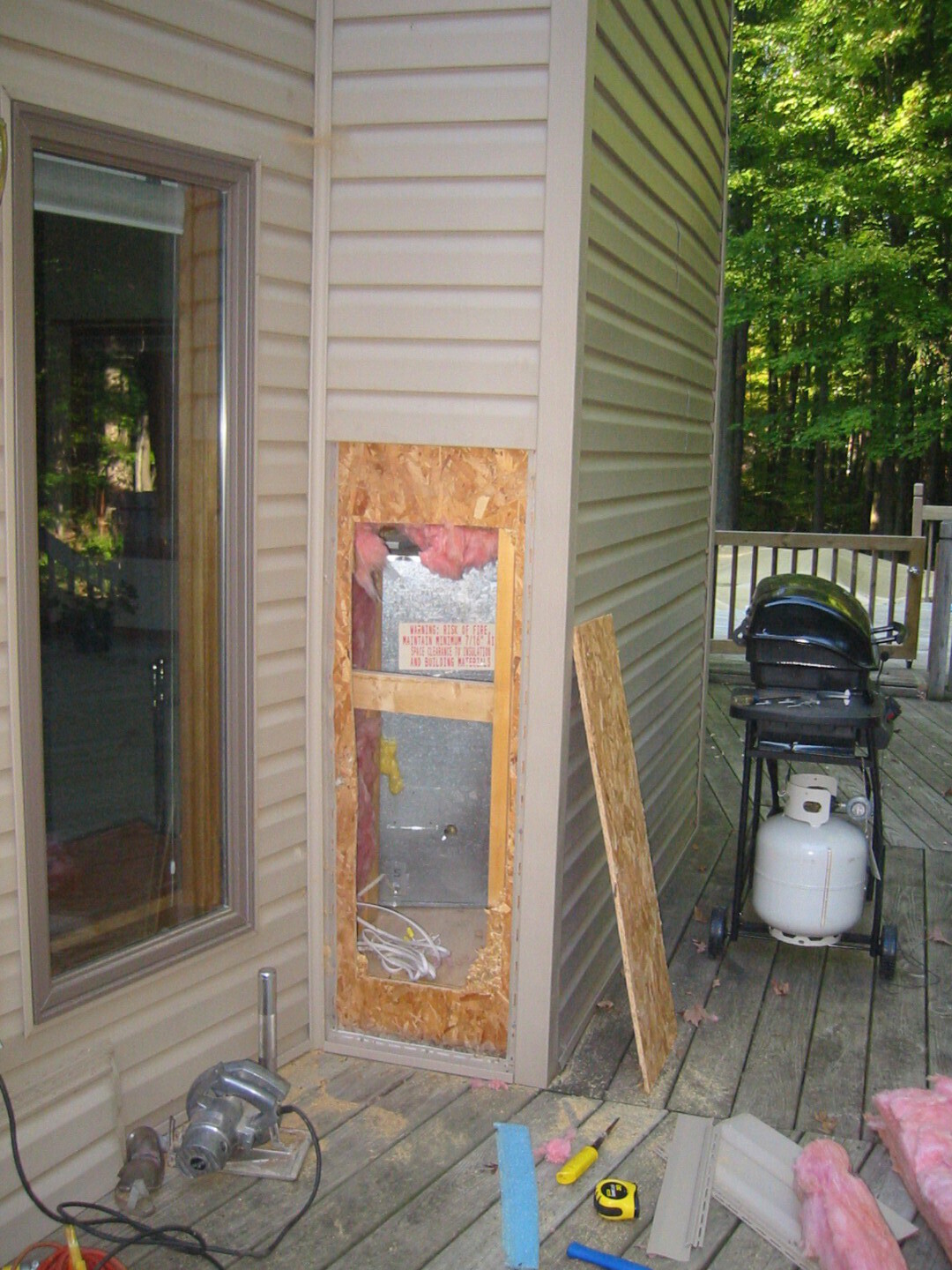

  6. 73blazer Member
    joined: Jan 29, 2008
    164 posts
    Birch Run, MI
    WHen I ripped out my old open ZC fireplace and installed the new North Star unit, I had to create access to my chase. It's not a hinged door or anything, but I made some cleats on the inside and screwed the piece of OSB I cut out back to the wall to the cleats and re-covered it up with the vinyl siding. I did screw some insulation and type X drywall to the inside of the OSB access panel to maintain the 'insulated' chase when it was all back together. The siding is easily enough removed and I can simply unscrew my little access door and get back into the chase if I ever need to. I wouldn't anticipate needing to do so, but, one never knows.
    I read the NFPA code book, there's nothing I could find in there about having or not having one.
    [IMG]
