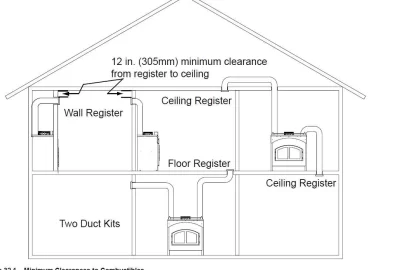

I am new to this site. I have heated my house for 16 years with a wood stove in our basement (Energy King). We are putting a 20 foot by 22 foot addition on our house this year. This will be a living room upstairs with either a woodstove or zero clearance fireplace in a corner, and a couple bedrooms in the basement. I have a couple questions for those who know about zero clearance fireplaces. 1) What would be some good brands to consider? I would like a good ash removal system. 2) Can I have one of the heat ducts from the fire place (located upstairs) routed to one of the bedrooms in the basement?? Thanks for your time and thoughts. Lance

Look for a high-effiecency, EPA-approved unit. Some good ones to consider are any of Fireplace Xtrordinair's models (if you like the heat-duct option, FPX is coming out with a new unit called the 36-CVT that can be attached to heat ducts- it's supposed to be released some time in June, I believe.), or Heat N' Glo's North Star (which can also be connected to heat ducts).
All the FPX models use catalytic converters, whereas the Heat N' Glo North Star uses secondary burn tubes.
I attached a diagram taken out of the North Star manual that shows ducting options:
