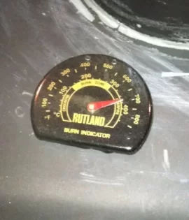

    Ok 13 is running right now stove top about 550 with air control out about 1/8. We had air control open she went up to about 720 and shut the air dropped down to 650 within a min. Man did I have some secondaries when I pushed the air in at 720. Stove works great. Any tips for a longer burn are greatly appreciated. I get about 5-6 hours although I did load up at 7 am and came home at 630pm stirred around my ash put some kindling and she lit right up

    whats the hottest you guys have had the stove top?

    625f or so.seemed like she could handle a lot more......I took the measurement under the top lip, about 2 inches over the door...dead center..with my IR gun....that seems to give me the hottest readings..I wish I could get her to hold 625 for a few hours...Nice heat at that temp...she seems to cruise for a while in the 400-450 range...That being totally shut down...

    I think the hottest I saw stovetop was about 700.

    reason I ask is an amature was using the stove last night and it got up to 800. Do you guys think any damage was done?

    Probably not. I would not want to run it at that high of a temp for too long. Brief periods during reloads should not do any harm. Let me guess, wifey running the stove last nite? :lol:

    Temps like that shouldn't harm the stove. The Dixette routinely cruises the 13 at 650 or so.

    I have an IR gun that maxes out at 716*. Center of my 13 routinely goes over that.

    naah you likely didnt hurt it but its not a temp i would want you to try to hold on the stove, could get right sporty running that hot for any length of time
