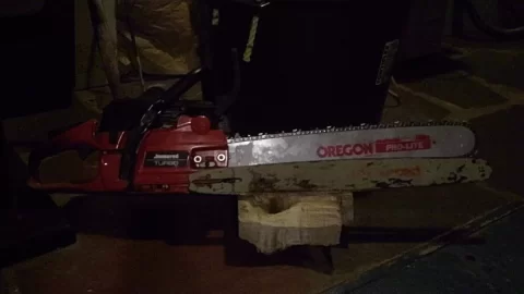

    My little saw came with a 20" .325" .050 80DL bar that is now done. Took it to a local shop and they sold me a pro-lite plus 20" .325" .050 78DL bar. Didn't put it on for a couple weeks to find the mistake, don't have the receipt and they won't exchange it.
    I have 4 new 80DL chains and 4 currently in rotation. I assume the cheapest thing for me to do is remove 2 links from them and use the bar I can't return? Is shortening my chains something I can/should try myself? I have an Oregon chain breaker and rivet spinner but have neither used nor seen them used before.

    I was/largely still am confused by the same thing Danno. The original Jonsered bar was 80DL and the Oregon Pro Lite Plus is 78DL. All other specs are the same and both claim to be 20" bars. Brand new 80DL chain fits perfect on saw/Jonsered bar. Take 2 DL out and the the same new chain fits perfect on the saw/Oregon bar.

    The effective cutting length of the original bar was about an inch and a quarter longer than the new one.

    Which would be good for about 4+ DLs, except the new bar is wider than the old. Gotcha. Sorry to be so confused about something so simple. As long as the pitch is the same, then I guess you should be ok.

    Yep, new bar is about 1/2" wider (taller if you will) than the old one. 2 DL out is perfect on it.
