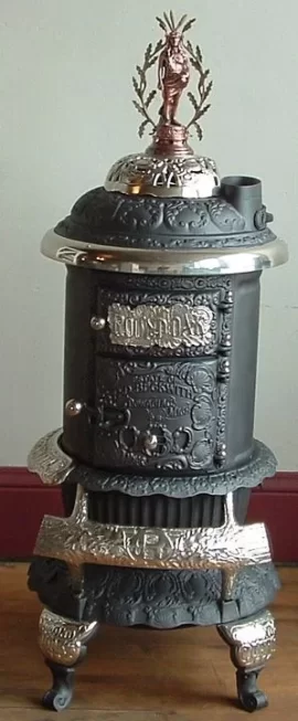

    Have any pictures of that old stove?

    Todd:
    I'm guessing this question was directed at me. Below is a pic of what my stove would look like if restored.
    Mine isn't anywhere near so 'shiny'.
