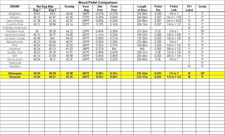

    Here goes nothing!
    I have a few brands to test and I hope some others will join in.
    If you purchase pellets on my test data without trying yourself first? SHAME ON YOU!!!!
    What I am doing and how I am doing it. Sorry but this isn't in any way, shape or form a lab test ;-P
    Temp measuring: I use a thermometer that doesn't touch the stove. I only measure the air temp from the convection air. The stoves heat setting is on 3 medium
    Ash volume: I swept the stove into the ash pan. I put the ash I recover from the stove in a mason jar to give it a visual on volume. I then vac the stove out in case I missed some ash. I don't want to mess up the next batch tested.
    Ash weight: I weigh the ash and record the numbers
    Ash Percentage: Divide the ash weight by the total pounds of fuel burned
    Density: I have a 288 cubic inch box. I fill it and weight the pellet and multiply by 6 to give the desity.
    Fines: I have a screen that I shift out the fines. Put them in a mason jar for a visual.
    Bag Weight: I weigh the bags and deduct the actual bag weight. So the weight is a net weight of the fuel only.
    Total burn length(how long the bags last): I added an hour meter in the convection blower curcuit. This curcuit is controlled by the POF switch. SO as long as the POF see's heat the conv blower has juice. Another feature we can now track. Besides the LG's the time listed is for both bags burned. Total net weight of fuel.

    Potomac's results
    Temp average 248ºF
    Ash volume 15 ounces
    Ash weight 4.8 onces
    Ash Percentage .37%
    Density 41.53 LBS.
    Fines 18 ounces
    Fines weight N/A
    Fines Percentage N/A
    Bag Weight Bag 1 40.24 LBS
    Bag 2 40.13 LBS
    Diameter .265
    Length 3/8 to 1 1/2 inches
    Total Burn Length: N/A

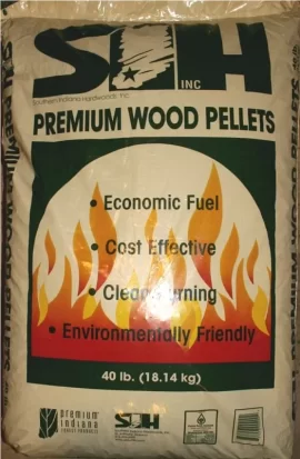

    Southern Indiana Hardwood results
    Temp average 250ºF
    Ash volume ounces 14 ounces
    Ash weight onces 4.96
    Ash Percentage .379%
    Density 45.98 LBS.
    Fines volume 8 ounces
    Fines weight 5.28 ounces
    Fines Percentage .4%
    Bag Weight Bag 1 40.14 LBS
    Bag 2 41.69 LBS
    Diameter .253
    Length 3/8 to 1 1/4 inches
    Total Burn Length: 25hrs 44min
    These pellet's were donated by Nick at Southern Indiana Hardwoods. Thanks Nick for the help in my testing challenge :)
    Pretty nice pellet from SIH. I will be looking for these Nick.

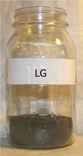

    LG results (these results are from 1 bag only)
    Temp average 247ºF
    Ash volume 6 ounces
    Ash weight 1.92 onces
    Ash Percentage .296%
    Density 44.29 LBS.
    Fines volume 4 ounces
    Fines 2 ounces
    Fines Percentage .31%
    Bag Weight Bag 1 40.48 LBS
    Bag 2 N/A
    Diameter .253"
    Length inches 1/8 to 1 1/8"
    Total Burn Length: 12hrs 20min
