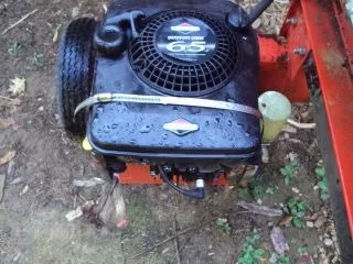

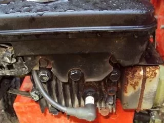

    Here are 2 pics of my splitter and the broken area and my temporary fix. I dont know if the break will show and I dont know how to put arrows or marks on my pictures.
    It works ok for now with the clamps on it.

  12. fidiro
    fidiro
    New Member 2.
    Feb 24, 2010
    283
    0
    Central NJ

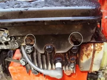

    That's why pics are best to explain problems. I thought it was the bottom end of engine where it mounted to the splitter frame/chassis.
    Try removing those bolts and use Big washers to try and catch some extra metal. Fender washers are a nice size but you would probably need to drill the washers to fit those bolts. The more the washer grabs the better the hold so get the biggest diameter washer that will work in the area to fit. If diameter of washer is too big grind problem spots to fit and grab as much flat metal as possible.
    Although this is a problem prone to failure, I wish my splitter problems were this. Others with the same design should go out and get washers to hold better to prevent this from happening, since it's a simple fix I would if I had this engine before it actually breaks like in the pics.
    Good luck

    Because it looks like the damn thing has been setting out in the weather for 3+ years. Anyway your engine appears to be the same as mine. If it is and you need to confirm all this based on the model # stated in an earlier post. You need a Housing blower Briggs part number 493294.
    The washer /sheetmetal will work very well if you attach them to the housing via tack welds, pop rivets etc..
    http://cgi.ebay.com/BRIGGS-AND-STRATTON-493294-BLOWER-HOUSING-NEW-/180563884922
    Or just stick with the hose clamp.

    looks like the recoil housing/fan housing/ gas tank in one? rust weakend the metal and the vibrations along with recoil forces did it in. I agree with fender washers, welded/brazed or pop riveted over the holes as a long term temporary fix. just remember if it is a fuel tank to take all precations while welding. The hose clamp, while effective in appearence, lends one major issue. If that is a metal fuel tank, and is vibrating and rubing around then its only a matter of time before it leaks. Probably on the muffler or cylinder head. then you will have more issues then just broken mounts. words of caution, feel free to ignore as needed!!! I know I ignore my better reasoning all the time!!
