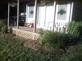

    I'll get some pics...now the cabin is finished and I live in it...measured out it is 375 sq feet haha 2 story cabin on lake access property in North East Ct.
    It has no basement it is built on a slab...I bought it from my father and he had built the cabin on a slab...if it was me I would have built it on a full basement so I could store the pressure tank, water heater, etc in the basement.

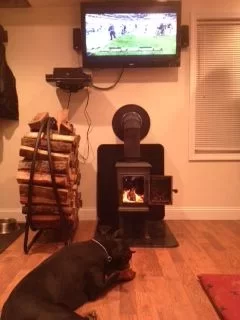

    Very Nice!! My wife and I are thinking about getting a flat screen TV as well. It will have to go near the stove. Our living room is about 14'x16. Do you have any problems with your TV that close to the stove?

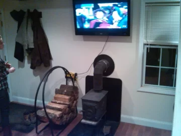

    I was wondering the same thing. I'd make a simple L-shaped heat shield out of sheet metal. It could be fastened on the wall with the L-leg on top so that you barely see it. Make it about an inch wider than the set and at least an inch deeper than the front, then place it about an inch below the TV.

    The TV is above the insulated portion of the stove pipe which I think helps some...I have put the back side of my hand up against the bottom of the tv a few times when the stove was really going and it was hardly even luke warm...Maybe it would cause damage but I am not worried about it after the way it has felt so far...I also have such a small stove that temps may not get as hot as some of the larger stoves cranked.

    I still need to get a shelf and mount the cable box and DVD player and run wires over to the left of the TV to clean up that area but I wanted to watch it in the mean time so I just ran that power wire down to outlet...looks dumb but works until shelf I ordered comes in.

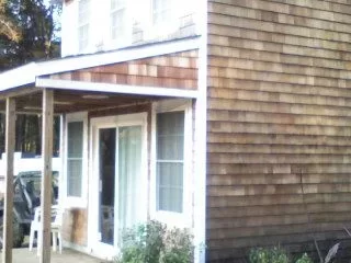

    Here is a recent shot
