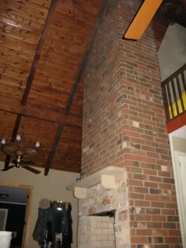

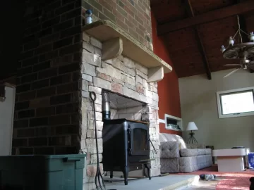

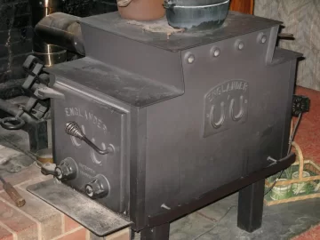

    Here are pictures of the new englander 30 I am talking about. I just installed it about a month ago. Pictured also is my old englander stove that heated this house for 33 years. Funny thing is that the new stove at 770 degrees was not nearly as hot as I have got the old stove. Until recently I had no idea of an over fire and many many times I have gotten the old stove red on the top. I mean painfully hot to even be within a few feet of the thing. It is 33 years old and not warped at all and has probably seen 900+ degrees well over a hundred times, if not several hundred times in its history. With the new stove, if I stay below 700 for fear of damaging the stove, it will never put out the searing heat that the old stove did, but I sure am glad I have upgraded. I love the view of the fire through the glass. The fires do last longer and it does burn a little cleaner. The old stove burned surprisingly clean as I only had to clean the chimney twice a year and even then got only a few handful of soot out. Maybe because of my fire burning habit is to burn hot and fast several times a day.
    The room the stove is in is nearly 500 square feet and the stove is nearly in the center of the house. I have only R7 insulation in the roof and there is 200 square feet of windows in the stove room. I need a lot of BTU's on a cold day but even with an extremely hot fire it rarely gets too hot in the stove room. With all the masonry around and above my stove it absorbs a huge amount of heat from the initial hot burn and is obviously released over time. The fire can go out and it stays warm for many hours afterwards.

    That's a fine looking install. That big Englander looks right at home there. Judging by those high ceilings, you picked the right stove.
