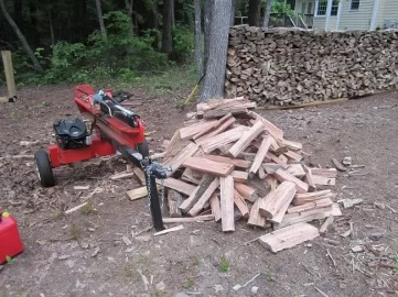

    After months of "planning to build one", reality set in and I went ahead and bought one from Tractor Supply. Bolted on easily enough.
    Let's see how my first attempt to post a pic works out.

    That will save you a lot of bending while in horizontal mode.

    Occasionally I "go vertical" to split larger rounds I can't seem to quarter with my maul. This one had some funny grain. You can see the maul marks from my splitting attempts.
    Ran through a few rounds yesterday and the catcher works well. Here are the fruits of my labor. Just like Fox9988 said, a lot less bending down.

    Damn, are you making toothpicks? Bigger splits man:)

    Figured I'd get some feedback on the size of my splits. The wife & kids can handle the smaller splits more easily. When my wife told me "it's actually fun helping you with the firewood when you make the pieces smaller"...I started making them smaller every once in a while.
    I have a few cords of larger splits scattered around the woodlot.
    Earlier this winter, one of the kids (I have three daughters) said "This is just like Little House on the Prairie". I thought...yeah, except for the efficient wood stove, the chainsaw, the gas powered splitter, etc...but then I said "Yep...sure is".
