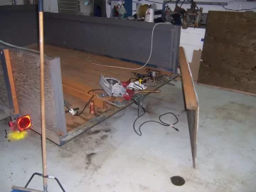

    I just replaced a removable one with a hinged/ramp one.
    2X4 across the top & 3/4 plywood. Mad a grove from 2X2s on each side to slide it into.
    A rope held the sides in when gate was in place.
    Pic of old one:
