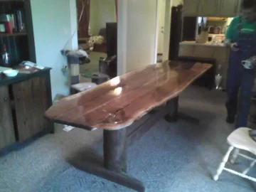

    I love the Minwax poly! It will POP! Shine will be deep and it could be a little slick for a floor but not sure.
