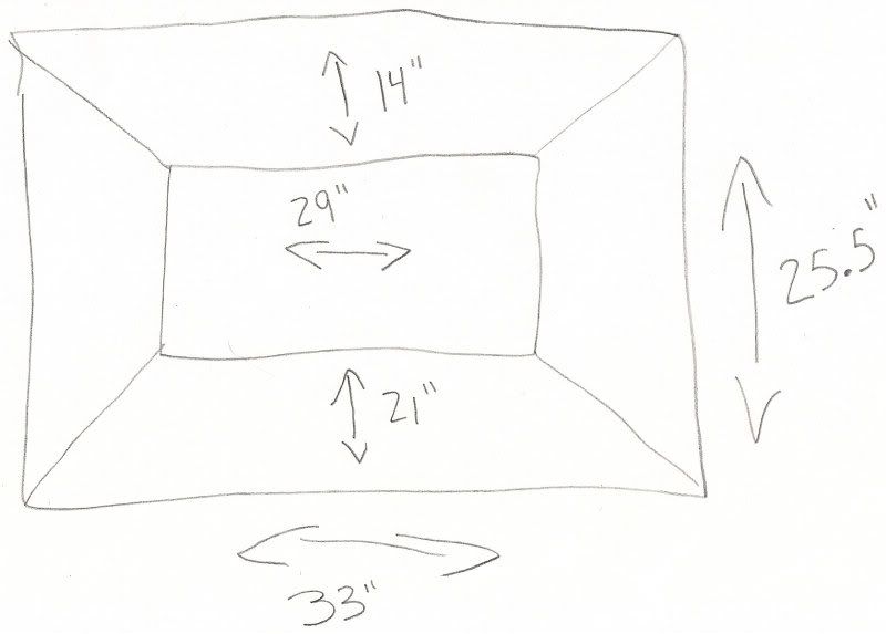

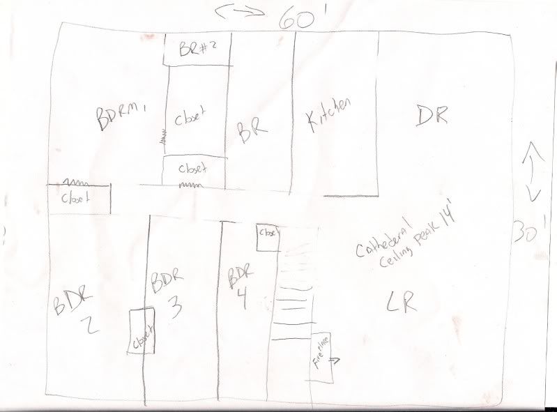

    I am new to the forum and I am looking to heat my 2700 square foot raised ranch with a pellet stove or pellet stove insert. Some special considerations that I have is the house is poorly insulated and I have cathedraI ceiling in my living room and dining room. The cathedral ceiling peaks at 14 feet. I have a ceiling fan at the peek of the cathedral ceiling. Last season from December to March I burned 900 gallons of oil. I am trying to cut down on my heating cost. I prefer a insert, but my main concern is heating the whole first floor of my raised ranch. Here is the lay out of my first floor:
    [​IMG]
    The dimensions of my fireplace are :
    [​IMG]
    I was looking at the quadrafire mt vernon insert but I just realized that my fireplace is too small for it. Can you guys recommend a reliable and efficient pellet stove or insert? I forgot to mention. If I go with a stove I will place it in my living room/ dining room where the 30' is in the picture.
    Thanks in advance

    I'd go with a Harman P68 and forgo an insert. Mostly because a stand alone stove is easier to clean, can hold more pellets (especially if you buy the hopper extender), and I think has greater BTU capacity. Thing is, you may have to build a hearth of some sort in order to install the stand alone stove and run the piping up your chimney.

    Chain Thank you for your advice. If I go with a stove, I think it makes since to put it where the number 30 is on the picture for a couple of reasons. First it will be facing the back of the house. Which should help move the heat back there. Second I can have the exhaust go through the wall. Do you have a harman? I read a couple of reviews that state their service department is not reliable.

    I agree with Chain on a free standing stove more btu's than insert also with a bigger stove you won't have to run it as hard to keep warm. I think that placing the stove on the back wall is a good idea easy install and pushing heat back in the living space.

    Biggest problem I see will be getting the heat into those bedrooms down the hall, especially after combating the 14' ceiling and poor insulation. This is an issue you will have with any stove.

    Keep in mind that with the angle of a cathedral ceiling the heat will "roll" down your hallway. It may work out better than you think!

    Does that stairwell go up or down? If it goes up, that combined with the cathedral ceiling is going to make holding any heat downstairs very difficult. Ideally, you need 2 stoves. One in the living room and one where the closet is at the other end of the house. Of course the closet would have to be remodeled. That one would really help get the heat to the bedrooms. Between the 2 stoves you'd probably be in good shape. Maybe you are a candidate for a pellet furnace?

    Thanks everyone for the advice. Flyn the stairs go down. I have a family room, laundry room, storage room and 2 car garage on the ground floor.
