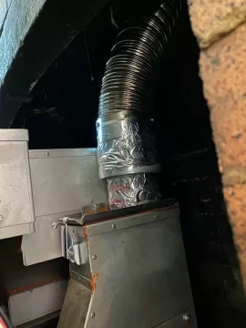

For a proper installation, there should ALWAYS be a cleanout -transition Tee in the venting. Could you please take some pictures of the install and venting for us to see? The only exception would be a hearth install and I'm presuming it's a freestanding unit, correct?
Pictures tell a thousand words they say...

Still want to see a drawing or picture of your exhaust venting. It's seriously deficient with no cleanout Tee and will be a constant source of trouble down the road. There MUST be a physical means to clean the fly ash out of the venting and that is a clean out Tee.
Reactions: Washed-Up
What is what we've got...
  • [Hearth.com] AGP Erroring Off
So, it's not a freestanding install, it's a hearth install but there is no cleanout Tee anyway, so all the crap from combustion is coming right back into the combustion blower.
