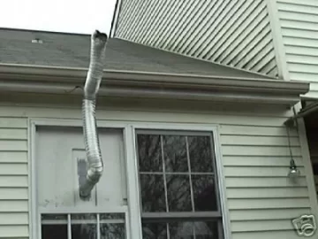

These pictires were taken from an Ebay auction a couple of years ago. The lister was bragging how easy and inexpensive
his stove setup heated this home. He claimed anybody could install it and was offering to include his vent piping as well.
thats right he vented using alumium Dryer vent pipe but the next picture is just as bizzare

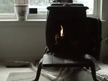

You are looking at his modified Volzang box stove. He had trouble drafting the stove but figured out a method to overcome his draft woes. By using a blower he connected the plastic tubes( seen running on the floor under the stove) into the fire box creating a blast furnace. He claimed that once it got cherry red it would heat his entire home and that he was able to turn off the blowers and it would remain red for quite some time. He also claimed that once he got it going the blowers helped distrobute the heat. On warmer nights he was able to re-load the stove and not need the blowers if he was able to load before it turned from the redish color. I emailed him and told him that was the most dangereous setup I ever saw, and the other safety hazzards. He pulled the auction. I saved the pictures so that all can enjoy and get a chuckle out ot it
MSG more pictures to post in your shop. Do you think he got a permit or an inspection? Does anyone see floor protection? Clearance to combustiables?

The scary things is that there are probably a lot of similar installations out in the sticks. Leave people to their own devices and they come up with all sorts of amazing "improvements". After all, this is flex pipe!
Aluminum? Well, it's metal, isn't it?
It is amazing that the flex did not melt - that stuff should be bye-bye at 1100 degrees, a temp surely reached if the stove was glowing red.
I must admit, I've only heard of one worse installation. This lady did not even have a chimney! She installed the stove and just fired it up in the living room! Luckily, she called a chimney sweep inquiring about how badly the house was getting smoked up.
I wonder what the clearance to combustiables for single wall dryer vent is? You think clearence might be a tag bit too close

I'm amazed that thing didn't start a fire on the carpet the first time he lit it. Hopefully he got more than one email saying "WTF are you doing?"
What is that under the stove he's using for a hearth? Looks combustible. Can't believe those plastic tubes didn't melt. He's damn lucky he's alive!
Wow, a home-built forge - in the house. Stove appears to be sitting on a couple sheet of durock or wonderboard. What that is sitting on is... carpet!??
I also like the deluxe exterior light fixture hanging off the gutter and what's with the 2" vent stack on the roof? Something tells me this house/homeowner is a time-bomb counting down for a darwin award..
