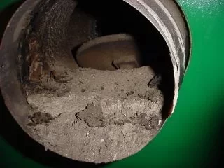

I cleaned out my eko 25 for the summer and removed the chimney connection pipe and it was half full with ash! Is this normal? there was really no creosote just a whole lot of ash. thanks for any info.

I get a lot of ash buildup too. I put on a tee so I could clean it out about once a month. I think this is normal.
If you have no creosote then I can't see how it could be poor fuel quality. I think it sounds quite normal.
Unless you found something different, likely just flyash, dusty-gray stuff that is pulled out by the draft and then falls down the chimney. Different woods produce different amounts of ash. I have found that aspen produces about the most, birch has a fair amount, pine just dusty small ash, and oak very little ash. I think aspen and birch are high due to the mineral content in the bark.
You might as well give up if you're looking for a wood species that will not produce fly ash when burned in a gassifier. I had assumed everyone accepted this phenomenon. I don't know exactly why there is so much ash suspended but always assumed that it was the violence of the combustion that caused it. I installed a sliding blast gate on the tee when I was running my Wood Gun so I could clean it out on a regular basis. That beast produced tons of fly ash. I just held a bucket under the valve and slid it open.
I found the same thing when I pulled my pipe a week and a half ago, burned mostly red maple and softwoods. Wish I had room for a T, I may fix the situation this summer.
Here is a pic

This is common with all the gasification units. Clean out the fly ash two or three times a heating season an you will be fine.
