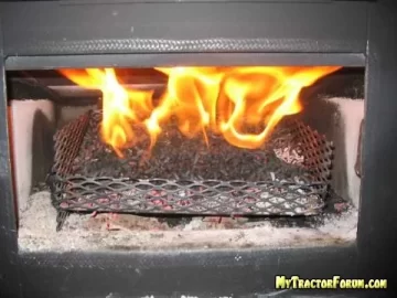

Loads of free, dry chips?

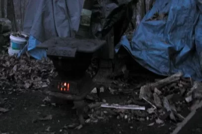

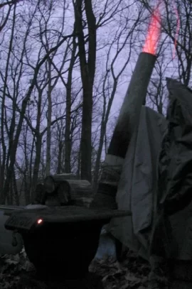

I have an old Fatso, I think coal stove, in my driveway. Since I do a lot of my processing in the winter I use it to keep warm while splitting and such. It was all beat up when I got it and I just use it outside and it kind of serves as my disposal. All my construction scraps, plaster lath, wood trim, 2x cuttoffs, gets burned out there where I don't have to worry about damage to my chimney. Also burn all the gnarly half rotted, moldy, small chunks & chaff from processing my primary supply.
Recently, had the fire going outside splitting a recent scrounge, as the sun was going down more & more I noticed the secondary burn coming off the top of my "stack".
