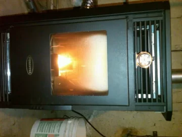

    Been running on medium (only 3 settings here) so far and great heat, good looking flame, gray (not black glass) and been keeping up with cleaning it with every load.

    The magnetic thermo on the side of my stove gets over 600 on Medium, Never really burn on High. If your stove if shutting itself off, then there is prob a problem somewhere. IMHO

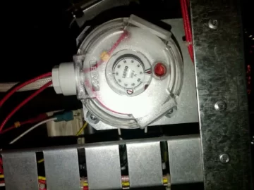

    Funny you should ask that..

    Sorry didn't complete the post..
    I thought of sending a picture to show what I'm seeing here.
    There's a nice dial and what seems to be an arrow, but this is taken after running all day on low and it's 20 degrees???
    I'm really missing something here...

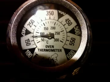

    This is how I check different pellets and where it's placed.
    Okay, so not entirely scientific, but it works and shows me a difference....
    This is also the temp it's been running on all day

    the white thing is the pressure switch and the dial does not move on it's own and you shouldn't ever have to adjust it.
    this is the hi temp sensor

    Your way of monitoring your temps, is one of the ways I check my pellet heat also. I have 2 magnetic thermo's. One is on the side of the stove (around 410 on Low and 600 on Medium). The other is on the front of the stove, but not directly in the middle. (Around 250-270 on its lowwest setting) Its a lil off to the side, but that because there is Zero airflow in the center. The 3rd and latest is a Digital probe meat thermomitor. It is much more accurate with the air flow temps. My Quadrafire only has 3 Heat settings. I Dont burn on High, and I dont plan to.
    To get back on subject, it is a pressure switch. Or your vacuum switch as stated above by Andy H. Just Google the name LEFOO. Its looks like the LF32. That is not the problem. If you lost vacuum, your stove would shut down after 1 minute. Your High Temp could still be tripping, but what you are looking at is not it.
    Here is the link, if not highlighted, then copy and paste in browser. (Vacuum LF32-02 20~200 pa) http://www.lefoo.com/prolist.asp?ProdId=0024

    The dial is where you set the pressure differential for the switch. Leave it where it is.

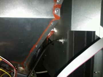

    So this is the temp sensor.

    Pulled the temp sensor, checked it, looked good and put it back.

    Yup, that is the correct sensor. Did you try keeping it plugged in but removing it way away from everything so there is no way it can reach 200 degrees? I'd just remove the side cover and have that sensor about 12" outside of the stove so it's at room temp. If you can run it on high like that it will tell you that the sensor needs to be replaced.
