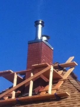

    I eneded up pre-soaking the bricks, used type N mortar (sets slower), and you were right, I could not possibly lay enough brick to cause the lower layers to squish. Did 9' vertical total, about 2' per day. First time I had ever layed brick so I'm happy with the way it turned out.
    Pulled 40' of insulated 6" liner up a 7.5" sized rough brick flue, that was not fun at all.
    The face of the chimney you see is just over 8' tall and it is a 2' section of class A on top.

    I used to work as a brick layers helper (not fun work)
    Even those guys as fast as they were, would just start and go all day. If your mud is mixed right you should be fine. First time? Looks great!

    Lookd great...You should be proud, I can't even imagine how bad my first try would look!! Especially since I would be scared on that scaffolding. Not a fan of heights!
