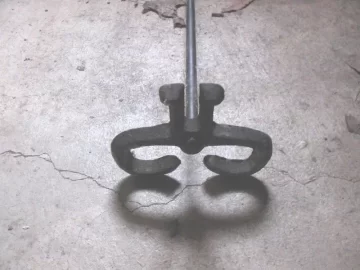

I used a fireplace tool set that I paid a buck for at a yard sale to make mine. Took it apart and used the pieces. Since the pic was taken I have hacksawed the two ears off of the top.
  • [Hearth.com] Any good ideas on making a rake?

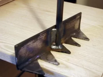

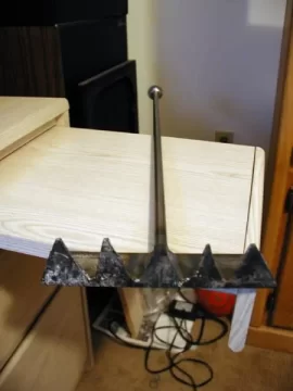

I fab'd this up last year out of some 2" L-Angle and 1/2" round stock, a little over kill but it works
