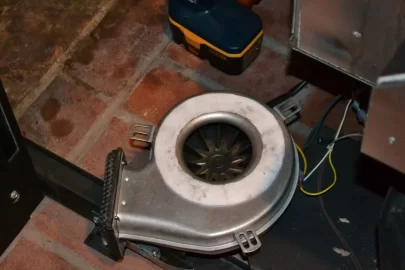

Scraped off the torn gasket and need to put the new on on!! Dumb question, How do I get it to stay in place so I can screw the blower back on??

Does the other side of that housing have 6 small screws going around it? Or is the blower, motor, and housing all one unit?

The motor mounts to the housing with 3 screws if I remember. I like to take the motor out of the housing and then the blower off the motor to clean the fins and housing once a year. It barely needed it even then. Probably could go multiple years. I used stove glass cleaner to get the fins and housing back to their old shiny self after vacuuming the stuck on ash with my shop vac.

I agree...not much crap on the fins, but it did quiet down a little after the cleaning!

Mad Dog, I will be looking for your contact for the Lytherm sheets as I am out 120.00 for four gaskets!

I think you could have used the 6" breckwell gaskets(ebay) for that blower. If the OD is 6" anyway. The bolt holes wouldn't have effected the seal.
