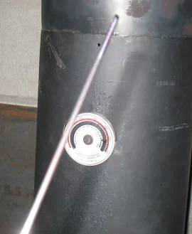

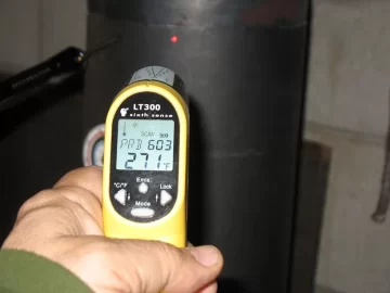

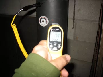

    As far as flue temps, you should realize that the only truly accurate way is with a thermocouple probe and a digital thermometer. As the season goes on, the soot and fly ash inside the pipe will act as an insulator and give increasingly lower readings at the same internal temperature. My IR gun accepts K-type thermocouples, so I got one that reads up to 1300ºF for another $40. It is only 1/8" in diameter, so it just fits into one of the flue pipe screw holes. I'll periodically check the difference between the two numbers at a few different temps to allow me to know exactly what the internal flue gas temp really is at that time in the season.
    The first shot of the sequence is of my pipe about 15 minutes after a stone cold start. You can see the IR reading is 636ºF, while the probe temp is 1281º. You can also see the old Vermont Casting contact thermometer ain't too far off... reading a little over 600º vs. the more accurate surface temp as read by the gun. If you doubt my flue gases were that high, check out the shot of the probe. Even though the camera flash robbed some of the color as it looked in the darkened basement, as you can see, it's glowing red as can be.
    The second reading was taken at cruising temp. The IR says 271º, the probe says 603º.... a great flue gas temp for my stove. The stove cruises at about 650-750ºF with a flue temp this high.
    BTW, the probe is even more accurate than the gun... about +/- 1ºF over its entire range.
