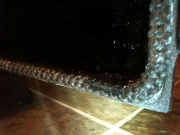

    I use the ash drawer on my stove every couple of days. When I opened the door this last time, I noticed a lump of hard black stuff had run down and landed on the bottom of the ash box (out side of the ash drawer) and had melted on my ash door gasket. I scratched as much of it off as I could, but it left my ash door gasket hard were it melted to it. I've never had this problem before. So I continued with cleaning the stove.
    I pulled the top and cleaned everything. There are no other signs of discoloration or creosote any where. Everything looks really good. I also cleaned the chimney. I got about a 1/2 of a coffee can worth from the liner. It also looks really good. There are no signs of runny black stuff anywhere, except for the ash box.

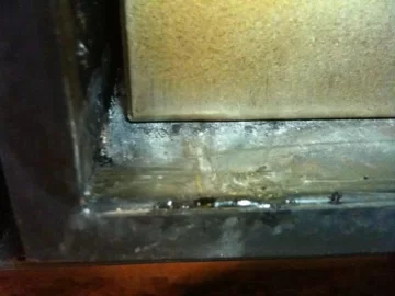

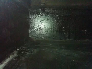

    When I removed the ash drawer I noticed quite a bit of shinny black stuff that has run down the wall of the ash box between the ash drawer. Anyone know if this is normal? or what could be causing this to occur? I attached some photos.

    Exhaust gasses must be lingering down there and since it is a cooler area, it condenses and sticks.
    Not really sure how you could prevent that. Its probably a fairly dead air space.

    That is really odd. May i recommend leaving ash in the pan. By doing this it will serve to keep it warmer down there and may stop your problem you are having. I would take the pics you have now and save them. Burn for a month with ash in the pan at all times then check and see if it has gotten any worse.

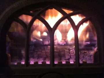

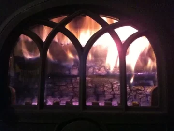

    My wood is good, two years split, dry, covered. I run the stove hot and cycle it. It's running just like it did last year. I never noticed this problem until a few days ago. Very odd. I wonder what happened to cause this?
    I will try and leave it full of ash and see what happens. I guess ill change that gasket ASAP so I don' have any trouble from it later.
    This was last week. I took too long brushing my teeth..... 600 degrees when I came back out to shut it down, it went to 625 then slowly started to come back down. The secondary burn was shooting out so far, it looked like it was hitting the glass, haha

    Looks like a combination of wet wood and slow burning.. Try running a bit hotter and drying your wood a few feet back from the stove (I would be sure to be keep an eye on it) to try and drive out moisture before adding it to the stove.. This should help..

    I get a little bit of glazing on my ash pan door and in some spots inside the ash pan compartment, but no dripping or heavy deposits. I even changed the gasket this year and the same thing happens. I guess if it ever ignited for any reason, the flames would travel into the fire box, so I don't worry about it as long as the door gasket isn't leaking air.

    No ash box here but I have similar in the firebox behind the firebrick in the back I summed it up to running the blower often and thus cooling this area of the stove causing the condensation. Turning the fan down and running a little hot every now and then cures the problem. I guess you have blowers mounted in the same fashion?
