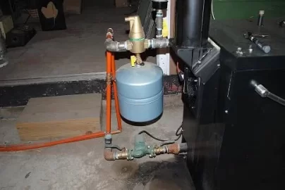

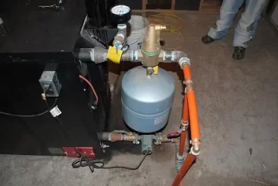

  16. HD08Rocker
    HD08Rocker
    Member 2.
    Nov 8, 2012
    30
    0
    Moira NY
    Here are sthe pictures of my furnace. The pex lines run thru my wall into my basement and into the heating lines from my oil furnace.

  17. Floydian
    Floydian
    Feeling the Heat 2.
    Dec 12, 2008
    459
    98
    Southwestern VA
    Hey Rocker!
    A few questions:
    What size is that pex? What model Taco pump? Do you know the heat load of your house? Have you verified the moister content of your wood?
    I think Taylor is spot on. You have got to be idling. A lot. And probably with wet wood.
    That pex looks small and your only going to be able to move so many btu's through it if thats the case.
    Hang in there, I am sure the smart folks here can help you get things straightened out.
    Noah
  18. maple1
    maple1
    Sep 15, 2011
    7,287
    1,259
    Nova Scotia
    Might be the angle or perspective of the picture, but it looks small to me too. Do I see two size reductions after the boiler tappings? I think I do see a return temp mixer though (Danfoss?) - which is good. And I also think it would idle a lot with no storage - try cranking the heat up on the thermostats while it's burning, use the house as storage. Flue gas temps would still help.
