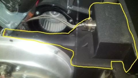

completely off topic, but do you have an outside air kit on yours? i'm in a big fiasco and could use some pictures :D

to my off topic question again, does the rear of your stove have this shroud? that goes from the area around the ignitor to the 2" oak pipe connector?
  • [Hearth.com] Auger did not feed this morning
My stove does not have the shroud. I have found, since I purchased my stove in 2003 when it was owned by Country, that the quality control on this particular stove has not been too good. I had my first stove replaced because the burnpot was badly out of alignment. To this day, on the new stove, I continue to have trouble with the alignment of the burnpot. I just ordered a new burnpot today because the bottom of it is cracked and falling apart. The last one had the side blow out. Not a cheap part $95...If I had to do it all over again, I seriously doubt I would buy a pellet stove and I do not recommend them to people unless they are the DIYer type.

interesting that there isn't a shroud on yours either. My contact at lennox says this is a welded on part from the factory and should be on all stoves.
