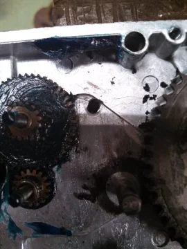

Was there any wear on the lower bushing ? I have an Omega but not the Maxx. I think the only difference is the fact that mine is a multi fuel. My lower bushing keeps wearing down to where the auger is scraping on the plate causing damage to the gear box. There could be damage to the 2nd gear box. I have gone through 3 motors so far. Good luck. Here is a pic of my gear box issue. The pin fell out because the hole became elongated.
Thanks for the reply and the pic. The last gear box I changed out had the same condition as your picture. I did look at the lower bushing and it looked ok, but after the auger jammed again I thought about the bushings. I was able to clear the jam and reinstalled the gear box and the stove has been running for the pass four days. Knock on wood. I’m waiting for new bushings, along with my third gear box. Good luck as well.
