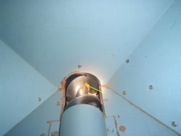

Recently I heard this faint, high pitched squeak every so often, coming from somewhere in the house. I crept around the house stealthily, pausing like a ninja waiting for the next occurrence to tell me the location of its origin. Eventually I found that it was my 1 year old Avalon Astoria that was the culprit. I watched the stove and noticed that the only times the squeak manifested, was when the auger light came on, but not every time that it came on.
I let the stove run out of pellets and cleaned the hopper of dust and pellet debris. I even stuck the shop vac up against the base of the auger to pull out all the pellets queued up inside. I read posts where a rogue pellet became wedged in between the auger blade and the auger sleeve, so I was very diligent in making sure it was completely clean. I reloaded the hopper and all seemed fine for about 2 days and then the squeak came back again, but louder!
Fast forward a few more cleanings and inspections, and the squeak is louder than ever. I was just wondering where the dealer contact information was, when it occurred to me that the problem might be unrelated to pellets. With the lid switch depressed, I watched the auger turn and noticed that it only squeaked during a specific 1/4 of it's rotation.
A puff of graphite and little WD40 at the spot where the base of the auger blade contacts the gold washer (click on picture and see yellow arrow location) did the trick. It's been about 4 days since then, and my Astoria has been quietly humming along.
Just wanted to pass my experience along to any other Avalon users that might be having a hard time figuring out the same problem.

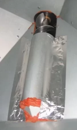

Avalon, you might want to actually remove the auger motor & auger to give the auger a good cleaning, and also clean up inside of the auger flight. Might be able to polish-up the back edge of the auger where it hits the washer, clean the inside of the bushing, and put some graphite in there too.
When I had my Astoria, I also taped over the screws that hold the auger flight cover so the pellets would slide all the way down....it helped some.
  • [Hearth.com] Avalon Astoria auger squeak - Problem & Solution!

Good idea Pete
Is that foil tape used for duct taping?

Avalon said:
...A puff of graphite and little WD40 at the spot where the base of the auger blade contacts the gold washer...
I'm pretty sure the "gold washer" is actually the end of the bushing that you are seeing and not a washer. The other part of it is on the backside of the hopper. I think they are pretty easy to find in most hardware stores if it gets worn.
