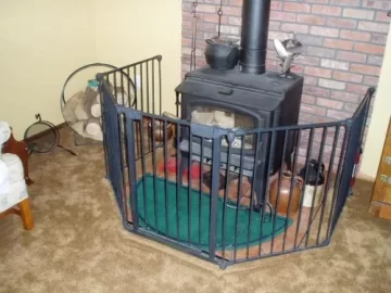

    So I have an almost-three-year old and another baby on the way (due in August! very excited!) and I'm contemplating how I'm going to babyproof my stove. We live in a small trailer, so it's going in the living room, which is where we spend pretty much all of our time. It's going along the back wall. The stove itself, the Englander TV-17 is pretty small, and has a 4x3 hearthpad.
    My older daughter I'm not too worried about, especially since this season I'm not going to burn 24/7 and will only do it when I have the opportunity to stay here in the room with her and the stove- there's no other place in the house to be besides my bedroom which is all of fifteen feet away, and I'm a stay at home mother. She knows enough about heat and fire and "hot don't touch" from helping me cook and not touching burners and candles and things. We have a pretty sturdy fireplace screen that I think should do fine for the casual leaning or touching it. [​IMG] It's high and wide enough that I can open the doors to load the stove, so that's nice. I'd like something reasonably attractive, since after I finish remodeling this mudpit it's BY GOD gonna look pretty! =P
    For the new baby, I'm HOPING he or she won't be too terribly mobile by the 2011 heating season... certainly not for the early parts, but maybe the tail end. I was doing some Googling and some people use wrought-iron fencing to construct an all-around fence. But I worry about the metal itself getting hot if it's too close. How far away would the metal have to be to not be burning-temperature? Warm enough to the touch might be a good thing, to teach them that hot = bad. I'm also low on space, so I was also thinking about using some of my leftover plywood/Micore/Hardibacker and tile to make a little wall on the sides with the screen in front of it? What would be a good way to make the scren less likely to tip? It has nice wide trapezoid legs on the middle section but not the sides- I can just see a new walker crashing into it and knocking it over towards the stove which would be BAD.
    I figure there must be a way to do it, since everyone used to have wood stoves and babies... How do you all protect your little ones?
    Thanks!
    ~Rose

    The only problem with that is that my living room is only about 12" feet wide- that would take up about half my floor.
    I was thinking of putting up two 24"x24" extenstions, basically to go on the sides of the stove, with the fireplace screen in front. Something like this- http://www.homedepot.com/h_d1/N-5yc1vZ1xi4/R-100548841/h_d2/ProductDisplay?langId=-1&storeId=10051&catalogId=10053
    Hard for a kid to climb on and cheaper than $180. Now just how to figure out how to make it stand up on the floor... Whatcha think?

    Yeaaaaaah. That falls under "bet I can't afford to lose". Toddlers fall down. My living room is cramped. I have two cats, and soon to be two kids, and they chase each other and run around. One of them trips, falls, throws a hand out near the stove, gets a third degree burn. I'm supposed to prevent that how, exactly? I could be watching them like a hawk but seeing as I lack the gift of foresight, I couldn't prevent an accident like that. I'm the farthest thing from over-protective- my daughter's allowed to help me stir things on the gas stove, help me light candles (with her holding the match), make BBQ fires, and I showed her to work the electric screwdriver the other day. Her idea of fun is whacking finishing nails into a piece of two by four with a rubber mallet. But that still doesn't mean I should be careless with the THOUSANDS OF DEGREES HOT FIREBOX in my living room. It's a steel stove. It's gonna get some hot surface temps.
    So, now that we've settled that debate (as far as this thread goes), whatcha think of the fencing idea?

    My point exactly. As I said, it's a bet I can't afford to lose. So the stove is going to have some kind of protection around it because I really DON'T NEED the $500 ER visit for a serious burn.
    Now the next post better be about how to properly secure the screen to the hearthpad so it won't tip over, how to make the KidCo gate work in my limited space, or how to get some 24x24 panels to go from the screen to the wall.

    Where I have the hearth on there is pretty much the only place it can be. The left hand side of the room has cathedral ceilings and it would be harder to get the pipe up through there, and it can't go on the bottom (where the bookshelf is) because there's a 4' wall there that I'd have to tear down and don't want to.
    If the gate could be basically be reduced by half and go around a 3x4 hearth, that would work great. Otherwise I'm afraid it's simply going to take up too much room to really be practical. Life in a tin box, I guess. =P

    Whatever you choose to use, I would say that it doesn't have to be too far away from the stove. The purpose (at least in my mind) is to just keep the kids from falling on the stove when horsing around, accidently tripping, etc. If the kid purposefully reachs through a gate and touches the stove, the burn received wouldn't be that bad and it would serve to prove to them that you were right in telling them to keep away it's HOT! I see the gate as preventing accidents, but it is not a replacement for parenting. I have seen some folks who don't get this and the stove becomes the "forbidden fuit" of sorts and the kid finds great enjoyment in throwing every flammable toy they have into this forbidden zone.

    Oh, I absolutely agree with you there. They'll still learn that the stove is hot, not to touch it, not to throw things over the gate, not to put things on top of it, not to run between my legs while I'm carrying firewood, don't play in the ash can, don't hit each other with the fireplace shovel... If it were just my three year old, I wouldn't worry at all, it's having a new walker that I'm most worried about.

    I have the same gate that has been suggested to you. Each section can be removed easily so you can customize the size easily. In fact I believe they make some 1/2 length 'extensions' - but I may be wrong on that point.
    As to where to get it - keep an eye on your CL postings. I bought mine from CL and I have seen them pop up quite often since then in my area. I imagine others (like myself) plan to use them just until the kids are old enough to no longer need the protection then pass them on. This is a very durable product - not much to wear out or break really.
    As to the temps - mine sits about 18-14" from the stove - if it really matters I can measure the distance for you when I get home. The glass can really get hot (measured over 700 at times with IR gun) and the gate has never gotten hot enough to burn but has been warm to the touch.

    As for bracing the panels from the screen to the wall... Get some large L-shaped shelf brackets, place the brackets on the inside of the screen and attach them to the screen's uprights with screws (nuts and bolts would be better). Screw the other bracket leg to the floor/hearth (be sure no electrical wires or plumbing are running under the floor there). Do the same thing with your fabricated plywood/micore/tile panels but also attach the panels to the screen with some short metal straps (screwed) and with some small angle braces to the wall.
    Or you could use a guy-wire system with wires going from the top of the screen down to the stove legs...wouldn't help on pushing against the screen but would help on pulling on it.

    I have a firebug 2 year old son, the kid co gate is highly recommended.
    [​IMG]

    I'm curious as to how long the side panels can be. My stove is a hearth stove and I need something like a 36" depth to cover hearth and stove with probably 36" to 48" width. ???
    I don't mean to hijack the thread, but curious about the possible dimensions of the gate/fence setup.

    rosie, i feel your pain. i had four kids around the stove ranging from two to 10. They learned not to fool around near it. They just touched it once and that was enough to straighten out their learning curve. That was years ago, and times sure have changed.
    Looking at your choice for a barrier, i wonder if the legs could be threaded so you could put a bolt on them and attach each leg to a weight like a brick, steel or even a 2 x 4 with counter sunk holes on the bottom and the fence would be self supporting. Just a thought. another option might be to use some zip ties to anchor two or three toghether, forming a hinge so at least they would be self supporting when put at right angles around the stove. I know it sounds a little redneck but the ties might work.
