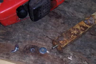

    Here's what I came up with.
    17-3/4", a 1/4" screw stud in one end, wing nut shake proof washer to the bar.
    tab/ear that turns up or down on the end.
    Can cut wood, dowel rod, 3/4 X 3/4" or a stick to what ever length needed.
    Can cut up to 12" rounds with out removing it (20" bar)
    Big rounds, mark log with the saw, then remove.
    Quick on & off.
    Maybe an earth magnet & stud to mount to the bar for even quicker on/off.
    Old piece of a fishing pole, fiberglass, carbon fiber with stud glued in the end would be even lighter.
    Plastic, synthetic or nylon bolt so it it falls out & you hit it with the chain, no damage to the chain.
    Will it work?
    Patent pending?

    I just got back in from the test run. WOW I was impressed.
    I thought I'd be fighting it & it would get in the way allot, but only a few times.
    I was able to used 3" of the tip to back cut the bottoms when I rolled the log.
    I bet I'm within 1/2" on every round.
    The only thing I couldn't do was stick the bar under the log to cut from the bottom up.
    It never came loose either.
    & I just found out it mounts to the little saw so I could use it to mark then big saw to cut.
    The end ear/tab is thin & fits into the kerf, so that was nice.
    I'm going to use it allot now that I test drove it & it worked fine.

    No death or injury wish here.
    I cut bigger stuff than the 3/4" thick stick so I don't know what about it is so dangerous?
    May be hard to believe, but it does work well for getting consistently the same lengths & was not
    a hazard. I was skeptical & real careful at first, but after a while I was cutting like normal but gettiing
    all 17-3/4' rounds (no more guessing).
    I was even able able to still use the tip (3'' of it).
    Comes off easy when not cutting rounds.
    Wouldn't have it on when felling, working in the brush, topping or de-branching.
    Next one will be a 18" piece of a broke fishing pole. (new improved version)
