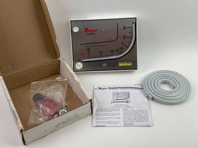

For manometer, Dwyer Mark ll model 25...$30-40 on ebay...no batteries needed.
FWIW, that manometer runs $45-$50 on ebay these days. There is a used one for $25, but is has bubbles in the tube which makes me not want to risk it. Amazon also sells it new for $53 delivered.
The air bubbles wouldn't scare me...you can work them out. Worst case scenario you pour out the oil and replace it, assuming that it has the red gauge oil with it still...that is stuff is pricey to buy by itself, so don't buy one that doesn't have it, unless its super cheap!
