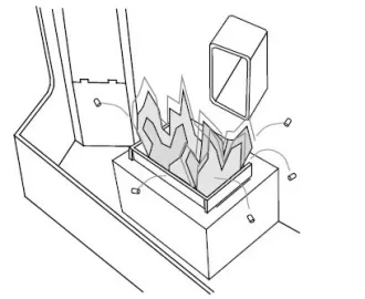

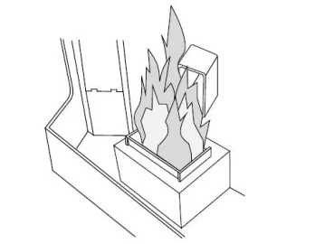

Here is what my wood pellet stove manual says:
Pic 1 - Not Enough Air.
Visual Inspection
Not Enough Air: If clinkers develop or the flame appears lazy and slow to blow the ash out of the firepot, pull the
restrictor outward until the flame becomes active and the firepot holes remain clean. NOTE: If the restrictor is fully out
(“5”), yet the firepot does not remain clean, the stove needs to be cleaned and checked for air leaks (see
“Maintenance” section of this manual).
Too
Pic 2 - Too Much Air.
Too Much Air: If the flames are too active (small, flickering flames) or if burning pellets are expelled from the firepot,
move the restrictor rod inwards until the flame slows down and no burning pellets are expelled. Another symptom of
too much air is the heater “blowing the fire out” – a condition in which the air pushes the burning pellets out of the
firepot, extinguishing the flame.
