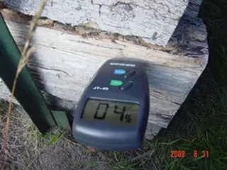

Here is the Moisture Meter that I purchased, it came in today.
Zap

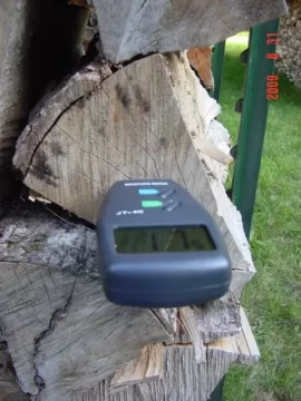

Here is another reading from some beech.
Zap
Zap
Zap your gonna have to split that wood and check it from the middle to get any useful reading. Testing from the ends like that is not gonna tell ya much.
Resplit any piece to measure the moitsture on the newly opened face. You'll be surprised that a previously split piece will read much lower than a round that is split for the first time.
Will resplit some splits and take a reading tonight.
Zap
