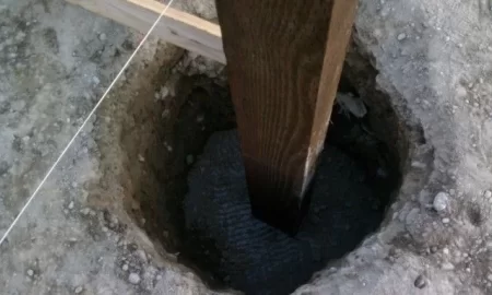

    And the pole has a HUGE amount of leverage on any mickey mouse attachment method. I was required to go 48" to bottom of pole. Pole on top of 8" thick footing and hole backfilled with concrete and two bars of rebar tying the backfill to the slab.
    My kids could hide in the holes.
