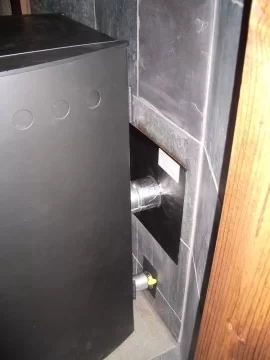

    pics of bosca spirit install
    3" selkirk pipe all the way up the chimney
    2" outside air intake.
    stove works well....heat output seems ok...thought it would put out more heat on the lower settings, currently running on "2"
    damper has to be almost all the way out(closed) or it seems to smolder down.
    it is 10 degrees out, and is keeping it around 64degrees inside.
