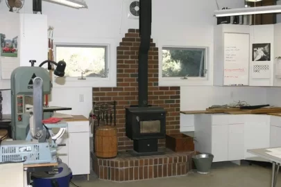

NFPA 211 says that 3 1/2" of masonry applied directly to the combustible wall buys you a 33% reduction of the required clearance. 3 1/2" of masonry with a 1" ventilated airspace between it and the combustible wall buys you a 66% reduction. I don't know what the manufacturer's required rear clearance for your stove is, but let's just say it's an old unlisted stove which requires 36". With the unventilated masonry you could then go down to 24"...still measured from the combustible wall to the stove. With a ventilated masonry wall, you could go down to 12". (In this case, then, the rear surface of the stove would actually sit 7 1/2" from the surface of the brick. Make sense? I have such a rear shield in my shop stove installation. I'll attach a pic. Rick

Not true. 3 1/2" of common brick provides an r-value of about 0.7...not a great insulator, but not zero. NFPA 211 recognizes this by allowing a 33% reduction in clearance for such an installation, as I pointed out in my previous post. Any shield benefits tremendously from the ventilated airspace, but the absence of that airspace doesn't mean the material has no insulative value at all. There will be a temperature decrease across the thickness of the brick facade, and that's what insulation is. Rick

Yes, that gives you your 66% reduction without the thickness of the brick. Of course, if the whole partiition wall is going to be ripped out (I'm assuming this is a non load-bearing wall :gulp: ), and a purely non-combustible masonry partition built in its place, then our whole discussion about rear clearance reduction is just an exercise in posting to the forum. %-P Rick

Thanks, budman. I'm hoping it's the last shop I ever have to build. Still need to do the countertops & sink & stuff, but I'm comfortable in it. OK, sorry...back on topic now. Rick
