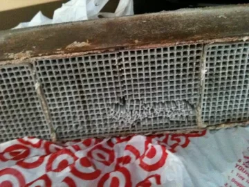

So I pulled my cat and swept the chimney like i do every year before I start the burn season.
I find the cat in this condition. The stove is a Fpx 44 elite installed november 07
It shows I have warranty coverage on the cat years 3 thru 5 coverage for thermal crumbling and Disintegration only.
Do I bother with the warranty or just replace with the steelcat ?
