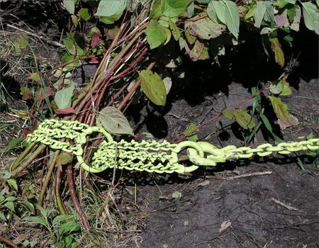

    Anyone use any of these Brush Grubbers?
    I was thinking of getting a smaller model to pull some small trees out on my property.

    I used em to pull pallets out of semi trailer, worked well for that as long as tension is maintained on what you are pulling. I think just a chain wrapped around the tree would work better though. If you are pulling over any kind of terrain that grabber may come loose and you will have to back up get off the four wheeler and reset it.

    On the contrary, for pulling out small brush or trees, a chain many times slips too much. Those things are made for pulling stuff out and not for dragging them like a log. For what they are made for they seem to me to be quite nice.
    Probably the bad part is that many times it might take 2 people. One to hold the tension while the other gets the tractor going. Can't you just picture it? Get all hooked on and climb on tractor. Whoops! Get back off and rehook.

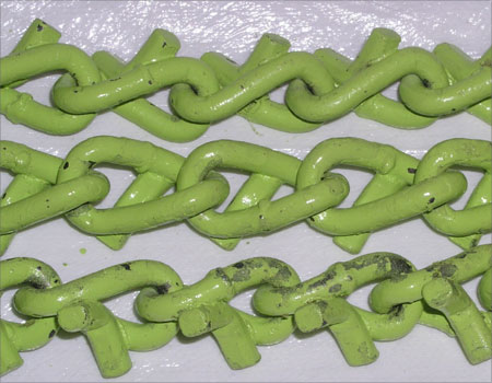

    I pull out black locust saplings and a few other youngins with a Brush Grubber Xtreme and a JD4600 tractor (over 4000 lbs with FEL) wearing R1 tires (see picture). If I pay attention to where I put it on the tree, it will not slip. The spring that closes the jaws is really strong, and the more tension you add when you first start to pull, the more it digs into the wood.
