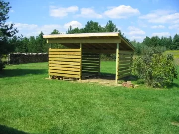

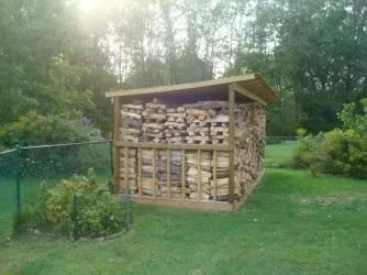

    This is what I built in my backyard. 20' wide x 10' deep x 7.5' tall.

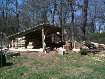

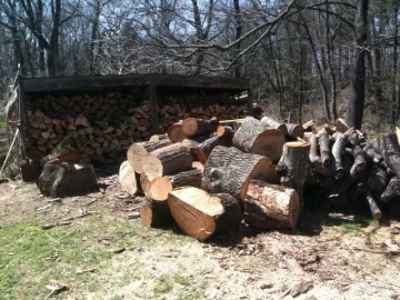

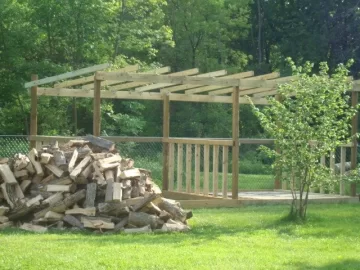

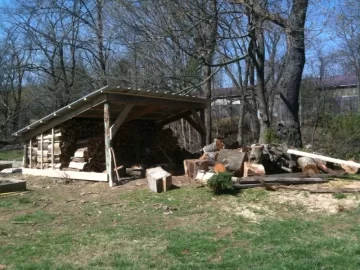

    I upsized mine the other day. Used a Cedar tree I cut down for the posts and some old and new lumber I had around. I built it around the existing pile so that was kind of a pain but I think I almost tripled the volume. It's not quite done yet I still have some things to do. I was thinking about putting some tobacco barn like sides on but I may just get some canvas I can roll up if I want to. Last picture is the old one. Good Luck

    Jlow, what did you use for a floor?

    Pallets laying on weed block material over grass.

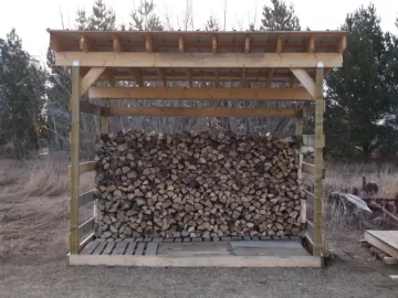

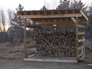

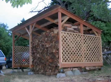

    Here's an evening shot of ours.

    All those buildings are real nice but if I had one of that type last winter in Iowa it would have been full of snow.

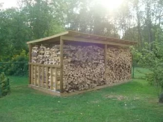

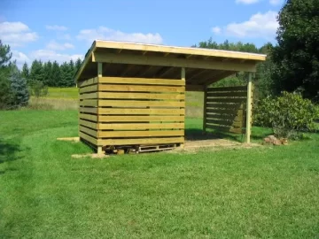

    Mine is not much different from the others already posted, but here ya go.

    Nice shelter I like the log posts.. Strong and inexpensive too..

    Good looking shelter I like the lattice on the sides dresses it up a bit..

    Good job on that shelter! With the sides like that do you also use tarps to keep snow out in winter?

    schortie, i like the front half wall i was thinking of this yesterday as i was stacking wood in my new shed for the first time. i think i will add one to mine as i think it will give me more stacking options when seperating fresh wood from seasoned wood. rather than piling new in front of old. i may also add more side boards so there's less space for splits to slip through. thanks for the idea!

    We didn't have a problem with snow in the shed. A dusting would come with stronger wind, but after knocking the splits together it was gone. This was our first season with the shed, and we were surprised that we didn't get more snow in it. It was great not having to deal with tarps or cramped space and wood mess in the garage.
