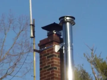

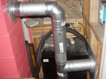

Hello
For 20 years I used the wood stove with 8" flue in my center of house cinder block chimney with clay liner. For the last 2 years I adapted the 8" down to 4" for my Avalon Astoria Wood Pellet Stove. The info I found recommends that the chimney should not be higher than 30 feet for a wood pellet stove so we both are all set!!
Also there are no combustibles near the exhaust!!
https://www.hearth.com/talk/threads/74298/
See pics. The Stainless Steel is for the house oil boiler that heats are hot water on 1 tank of oil per year!
