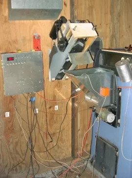

Someone here sent me a file with an update of a guy that has converted his Tarm Solo to burn wet woodchips. If I recall correctly, he is a retired mechanical engineer and his setup is impressive. Apparently he heated his house in 2006...don't have any more up to date info than that.
PM me and I'll happily share the file.
Maybe someday I'll have time to attempt this. It would be a great way to use a waste product to heat the house and be one step closer to carbon neutral! Maybe someday.
