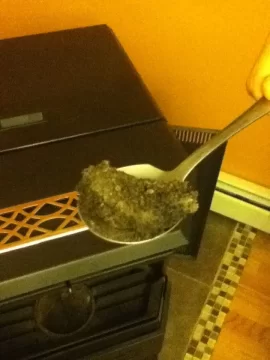

because of the warm temps, stove went off a couple times yesterday and then off this morning. Checked the burn pot and i didn't like the clinker, not a full bag burned and there was a clinker....:(

Hmmmm Ive burned just under 2 ton of gt this year and haven't had a clinker. Is your stove a top feeder? Any agitator?
Top feeder, no agitator.
Burned about two ton GT so far. Yes they can be ashy, but overall a clean burning pellet (no clinkers here).

Geek, About all you can do is try increase the combustion air and/or reducing the amount of feul feed in. If the clinker was bad? I'd do both. Your stove doesn't have a damper. But does have both combustuion trim and feed trim. Try raising the combustion air up 2 settings. Maybe even drop the feed trim a couple as well.

Medium size clinker but it formed too quick in the run. Since temps are getting warmer it might be late to try trimming those settings but let me check the manual and try that today. the flame seems a bit lazy with GT so let's see if changing the trim settings help also.

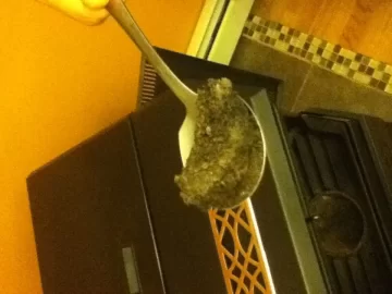

Lazy flame is not a pellet problem....it's an air problem, as mentioned above. GT's burn just fine for me during testing, and no indication of any clinkers.
here's a clinker,,,,this happened overnight.

fixed view angle
