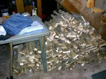

    $100 dollar bills?;)
    I burn lots of pallets, the OPE store around the corner puts out these nice oak pallets, they are easy to take apart, then I cut them up with a radial arm saw. I always like to keep a good supply in the basement. I use pallet wood to start my fires, for my stove I can put in a good size load of pallet wood and not worry too much about over firing, as my stove is not that big and I have digital temp/alarms to monitor the stove and flue temp.

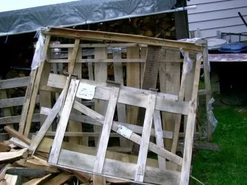

    My workplace receives raw steel & aluminum sheets on over-sized (3"x4"x12' runners with 1" oak or 5/4" pine x 48" top slats) pallets in either all oak or pine slats on spruce runners (they are definitely lighter and easier to remove nails from!).
    In this case, these are untreated, kiln-dried wood, and I'll will be using them a lot this winter. (Once I get my new Summit installed.) My company has to pay to dispose of the pallets, so they are more than happy to let me have 'em! Smaller pallets might be treated or scuffed badly, and I wouldn't be so sure about them. I've even seen ones that are stapled together!
    Cross slats are spaced about a foot apart, so it's very easy to use the leverage of two loose boards to pop-up the nailed ones. Sometimes the nails stay-put in the runners, especially in the oak, and the nails are all spiral variety. What I've found to work best at removing those nails is putting a small pry-bar (12" or so) under the nail head, flat-side-up, and then use a 36" bar underneath that. Otherwise the curved shape of the pry-bar or hammer's claw will just deform the nail head and send it flying. In cases where the nail head goes flying, I have a Dead-On-Tools extraction tool that I'm very fond of (I think it could remove a splinter from my finger!)
    That amounts to about 60+lbs of oak/pine in about 5-7min of work to remove nails and a few more minutes to saw it into 16-18" lengths. The pine slats are also easy to split into kindling.
    And I plan to mix the sawdust with old candles to make some small fire starters - a coworker of mine uses paper egg-cartons as molds, 12 per box.
    It does burn fast, but it stacks better than anything else and the price is right! My FIL thinks I should just burn it with the nails still in, but I don't want a red-hot nail to damage the firebox or the glass for that matter.
    TJ in SE Wisc.
    PS These heavy pallets are also great for swing-sets, picnic tables, saw-horses, etc.
