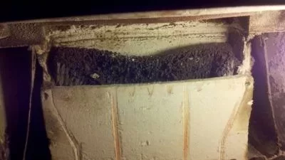

    If the refractory is just cracked maybe you can get away just adding a cat, hard to say without seeing it. Can you post a pic?

    Her's a pic. The front piece "refractory access panel" is in three pieces & will without a doubt needs replacing. Can I run the refractory like this? As you can see the Cat is a total goner.
    (also- sorry for the pic quality, the forum wouldn't let me upload the original size of the pic so I had to re-size way down)

    Kind of hard to tell, but the assembly looks to be in decent shape.

    Alright..... I broke down & ordered the access panel & catalytic. I guess this will buy me two years or so, which should provide plenty of time to save up for a nice new NON-CATALYTIC stove. After much research, I found a catalytic for $190 shipped & the refractory access panel for $68 shipped (thanks to BrowningBAR) $258 isn't too bad I guess. Thanks again for all the help.
