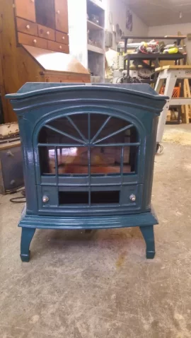

Can anyone identify this propane stove?
Dallas75
Nov 8, 2014
3
bracebridge ontario
I bought this propane stove last week and unfortunately the rating plate is missing. It looks like a Vermont castings model. Any help would be appreciated as I really want to install this stove.
Thanks in advance, Dallas

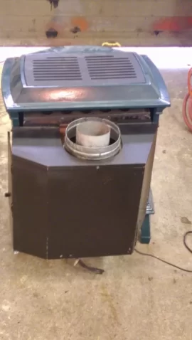

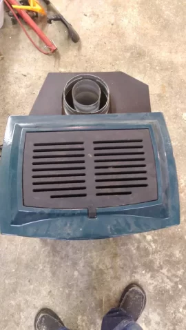

Thanks for the reply Dave, I looked up the heat and glow on the web. My stove differs from the Townsend because of the way it is vented. The heat n glow is vented right out of the steel grate on the top and my stove is offset to the rear of the unit. I want to know if I can vent this stove into a clay chimney with a liner and bvent adapter is what I want to know about this stove.
It would probably work to just connect the stove to a b-vent pipe, but you really should set it up to be a direct vent as designed.
you need a simpson dura vent masonry chimney adapter, here is some info to get you started
(broken link removed to http://www.duravent.com/docs/product/directventpro_L820_2012-sep_w.pdf)
