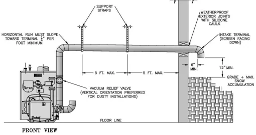

Do you have any opinion on an outside air kit for a Burnham boiler? Burnham makes one, not that expensive, I just don't know if it'd be worth while.
I realize the air shutter would have to be adjusted for afterwards.
Thanks.
I only use Field Controls direct venting kits.
yes they are expensive but they are quality.
If the manufacturer recommends their device, use that.
I think it might be around $150 or so.
Here is a picture from the Burnham manual.
They recommend galvanized pipe-I imagine it should be insulated somehow.
